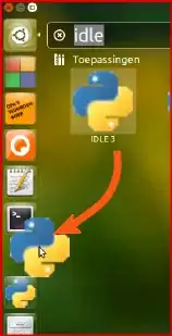

The simplest solution
Here's what you can do (simpler than you feared :) ):
  • Open Dash
  • Type Idle (or Idle3, depending on the version)
  • Drag the icon from Dash to the Unity Launcher:

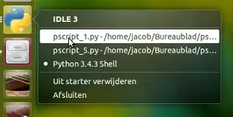

    Then the right- click text sais:
    (Which is Dutch for: "Remove from launcher")

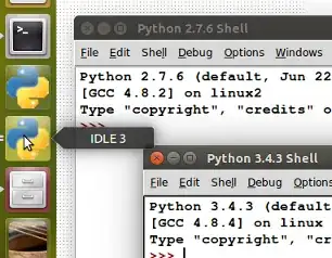

As a result of the fact that windows of one WM_CLASS in principle only appear under one Launcher icon (at a time) in Unity, please note:
Although the chances are practically none, grouping Toplevel windows under the Idle icon could show a downside in rare situations:
  1. If you run different versions of Idle at the same time (e.g. editing code for two python versions at the same time), all windows are grouped under the icon of the version that started first:
  2. If you run python applications, using tkinter as a GUI (quite unusual these days), usually secundary windows are set as "child" of the main window by using wm_transient()
    In "unpolished" applications (like Idle), this might not be the case. In such cases, the secondary window ("Toplevel" windows in tkinter), will also show up under the Idle icon, If Idle ran first.
But again, normally this will probably never happen, and if it does, it does no harm but what I described.
