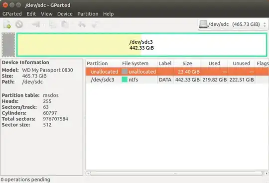

Long story short, I have an external USB hard drive formatted using a MBR partition table, and I want to install Ubuntu in UEFI mode in a ~23.40 GB unallocated space before a ~442.33 GB NTFS partition that I need to keep:
screenshot
To install Ubuntu in UEFI mode I need the partition table of the drive to be formatted as gpt.

  • If the final partition on the disk ends too close to the end of the disk, it may need to be shrunk by a small amount -- just a few sectors, normally, although many tools will require rounding to 1MiB units, so you may lose 1MiB or so. GParted often ignores tiny gaps like this, so it's unclear from your screen shot if you'd need to do this.
