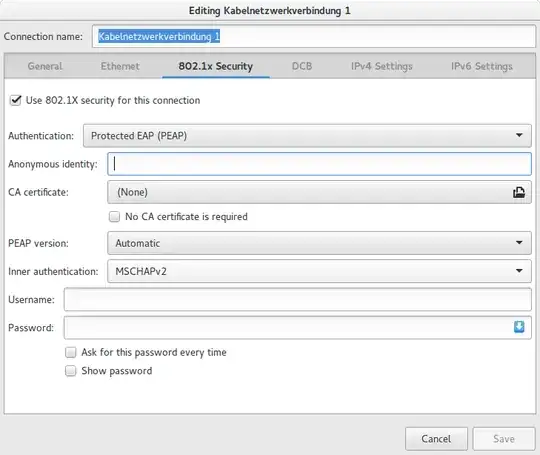

Open your Network Manager and use the Security tab.
Enable 802.1x Security and select Protected EAP (PEAP)
