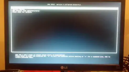

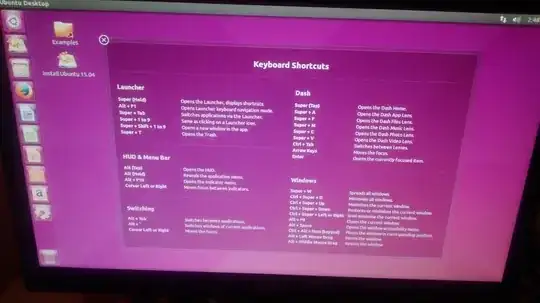

  • Load it as a live OS DVD. enter image description here

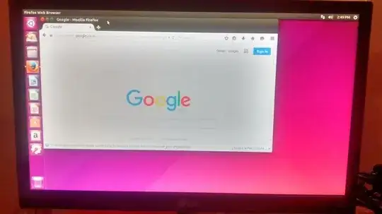

  • Live OS loaded. enter image description here

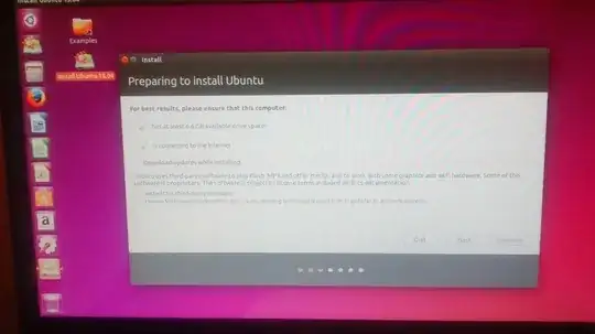

  • Started installing Ubuntu 15.04 enter image description here
  • Selecting options. enter image description here

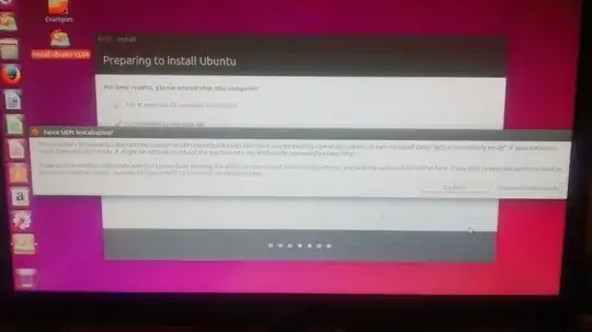

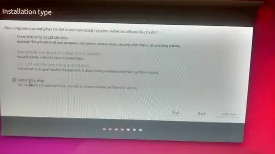

  • On clicking continue in previous step i got this message, i thought it might be a warning tried to skip this. enter image description here
  • It is not able to detect any operating system, hence i selected the option "Something Else" enter image description here

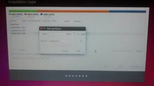

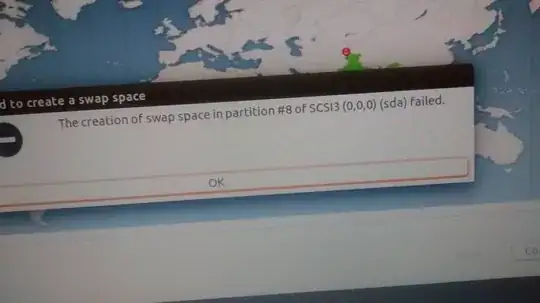

  • I tried creating swap of 8GB, same as the RAM size in the drive representing E: drive for windows. enter image description here

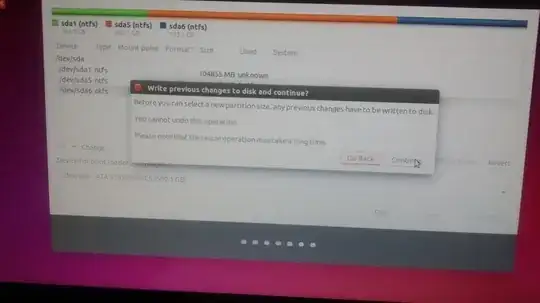

  • I got some warning for data back up which seems fine. enter image description here

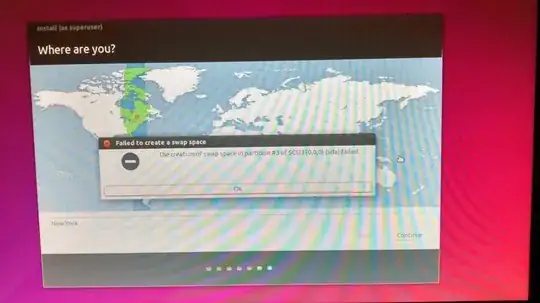

  • Then it flagged an error, swap cannot be created. enter image description here

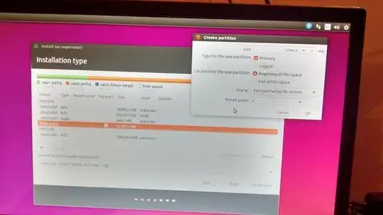

  • Then i created rest of the space of E: drive (in respect of windows) as ext4 partition for / (root)
  • Then on clicking continue, i again got this error and i can't continue further, hence i have to forcefully shutdown. enter image description here

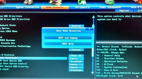

I even tried disabling the UEFI mode from boot setup: - Those are the two options i was able to find related to UEFI mode: enter image description here

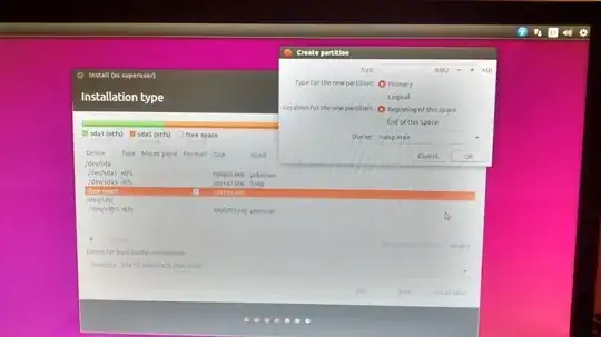

  • creating swap enter image description here
  • creating ext4 partition enter image description here

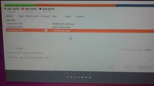

  • this is how the final structure. enter image description here

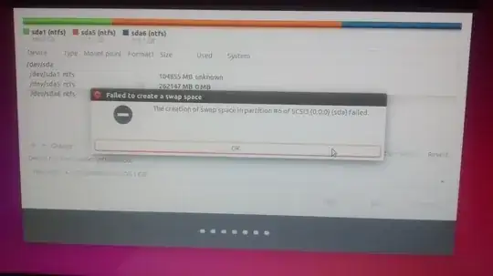

  • clicking continue, got the same error as swap cannot be created. enter image description here
Please Help, i think this is not going to work out?
  • I tried with simple ext4 partition creation, not having swap. It failed at the end.
Ubuntu and all other GNU/linux doesn't work under NTFS. Format one of your drives as ext4 in which you want to install Ubuntu.
For example you may click on /dev/sda6 and click "-" to delete ntfs partition. Then you may click "+" and make that ext4 partition and then proceed.

first format a drive upto 30GB or more and then try to dual boot by the above steps.Make sure the space where u want to install ubuntu remains unallocated.
