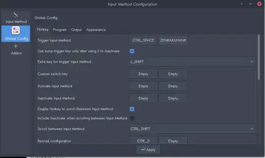

This old question is still useful, in my opinion, fcitx-mozc works wiser and efficient than ibus-anthy (it's rather light weight)
install fcitx-mozc:
sudo apt install fcitx-mozc
open Language Support, set Keyboard input method system to fcitx.
open Input Method Configuration and Input Method tag, choose Mozc from Available Input Method list.
(you can find it when Only Show Current Language is unchecked)
then, open Global Config tab,and set Trigger Input Method. (tap the empty button,and click a key whatever you like)
Now you can type in Japanese, I think.
