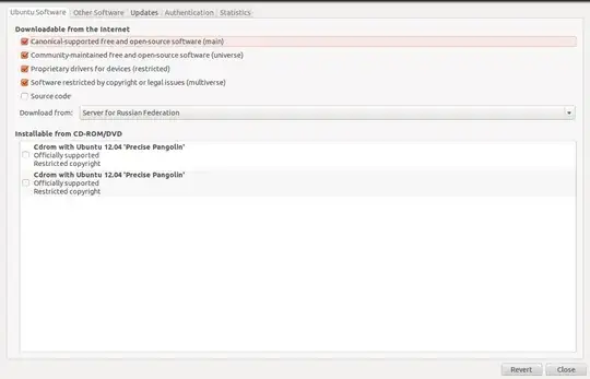

In 12.04, I have neither an additional-drivers tab in update-manager:
the update-manager in 12.04
nor an additional-drivers app in the menu, nor such a program (checked by locate), nor such an installable package (checked by apt-cache search).

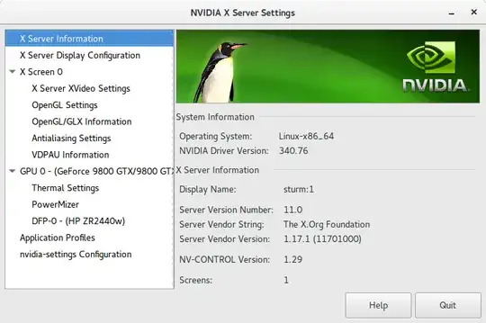

  • nvidia-settings
  • nvidia-settings -q NvidiaDriverVersion
      Attribute 'NvidiaDriverVersion' (sturm:1.0): 340.76
      Attribute 'NvidiaDriverVersion' (sturm:1[gpu:0]): 340.76

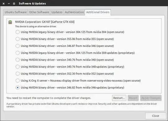

Just open the additional-drivers app, search for it in the dash, or in software and updates
In 12.04 you can download an additional drivers app HERE.
