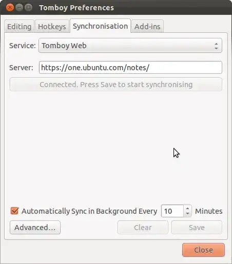

My web browser opened, and I logged in. I get the message "Tomboy Web Authorisation Successful - Please return to the Tomboy Preferences window and press Save to start synchronising". So I returned to Tomboy to find the window below.
As you can see, it asks me to press save, but the save button is greyed out!
8128
  • 28,868
This is a known bug:
Launchpad Bug #845321
When setting up Tomboy to sync with Ubuntu One I'm unable to click Save in the Synchronization tab in Tomboy Preferences.
After getting the "Tomboy Web Authorization Successful - Please return to the Tomboy Preferences window and press Save to start synchronizing." screen in my browser I'm unable to actually click Save.
The Tomboy Preferences is stuck at "Authorizing in browser (Press to reset connection)" and the Save dialog is grayed out.
In the meantime before it is fixed, you could try the workaround described in comment #16:
The save button was always greyed out for me. Today I tried again and found out, that editing the server field enabled the save button for me.
  1. Edit server field. (Add a character and remove again)
  2. Connect to server
  3. Save
