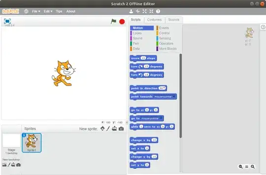

To install Scratch 2 Offline version it is necessary to:
  1. install Adobe Air
  2. install Scrath 2 with Adobe Air
But it is a nightmare to install Adobe Air.
Luckily I've found here (in last part of the page) a small script that runs perfectly and does everything on 18.04.2 LTS for me.

  2. execute this script with sudo
  3. now it should be installed, just search Scratch 2 in your application and launch it !
