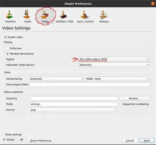

I had installed VLC media player from the Ubuntu Software Center recently. It worked for some time, but then instead of the video, only a blank screen was displayed with the audio. Even the same videos that could be played before did not work.
I tried uninstalling and re-installing, and I upgraded it to the latest.
I've tried: menu ToolPreferencesVideo → enabling Accelerated video output (Overlay).
Execution via the terminal also gives the same.
I'm using Ubuntu 14.04 (Trusty Tahr).

    • Go to ToolsPreferencesVideo
    • Remove the tick for Accelerated video output (Overlay)
    • Try and play the movie again, you should now see output.
Or
2.
  • Go to ToolsPreferences->Video
  • Change Output to X11 Video output
If the above doesn't work, that particular video might have a proprietary video format that is not supported.

: menu Tool → Preferences → Video
Check the output drop-down menu
and check that you have chosen the appropriate output codec, It was set to "auto" in the drop-down and needed to be selected "X11"

I'm using Ubuntu 16.04 and updated to vlc 2.2.7. I had the same problem after updating the update.
Go to Tools -> Preferences -> Video -> Output and select any of the first three options that end in (XCB). This resolved the issue for me.
janitor-
You can also try either of the OpenGL options and they also work.

In my case (Kubuntu 18.10 x64) changing Output to X11 Video output (as Ravan proposed) did not help, but XVideo output (XCB) helped.
So...
  • Go to ToolsPreferences->Video;
  • Change Output to XVideo output (XCB).
