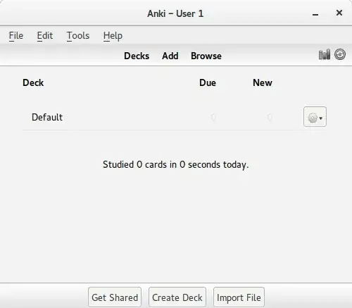

Here is the Anki app

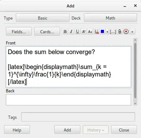

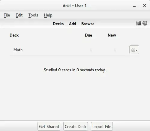

    Click the button Create Deck in the lower part of the main window and create a deck, in my example Math
  4. Click the field Add below the menu bar…
    …and add some LaTeX, eg
    Does the sum below converge?
    [latex]\begin{displaymath}\sum_{k = 1}^{\infty}\frac{1}{k}\end{displaymath}[/latex]
    and click Add and Close

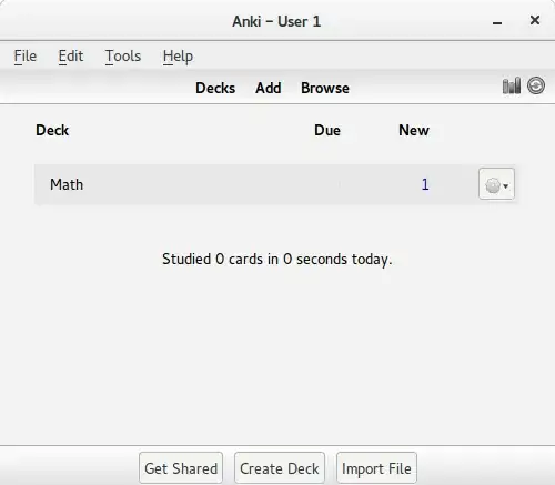

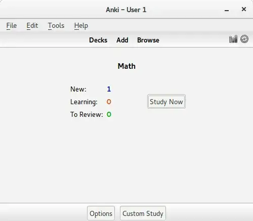

  5. Click the entry Math
    and you will see this

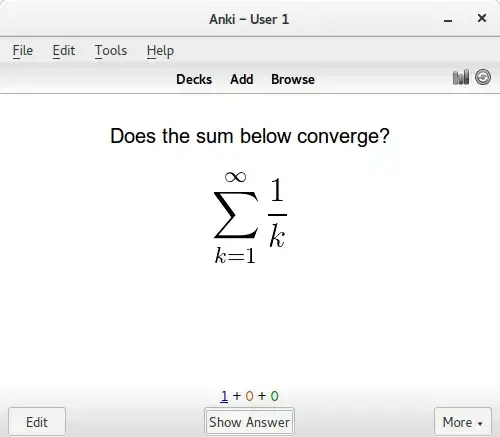

  6. Click Study Now
    …and you have your LaTeX
