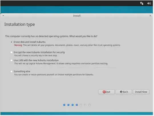

When the options titled "Installation Type" comes you are given a choice between:
  • Erase disk and install Xubuntu
  • Something else
Installation Type Screenshot
Choose: Something else

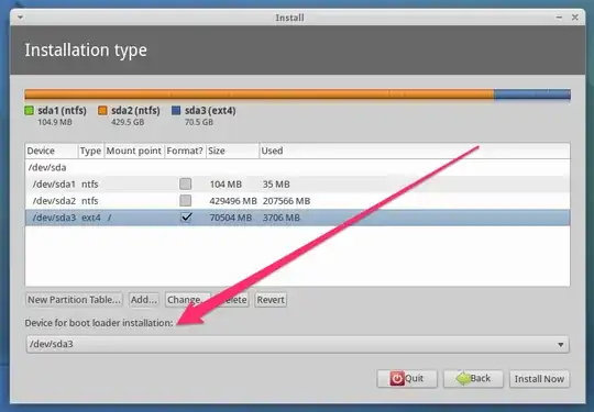

At the bottom is a pulldown menu titled Device for boot loader installation, select /dev/sda
Installation Type Partition Screenshot
Now click on the Back and proceed with Erase disk and install Xubuntu
This should solve this issue.
