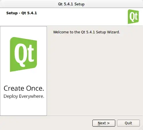

Make the file qt-opensource-linux-x86-5.4.1.run executable
chmod +x ~/Downloads/FlareGet/Applications/qt-opensource-linux-x86-5.4.1.run
Run with
And you will see this
