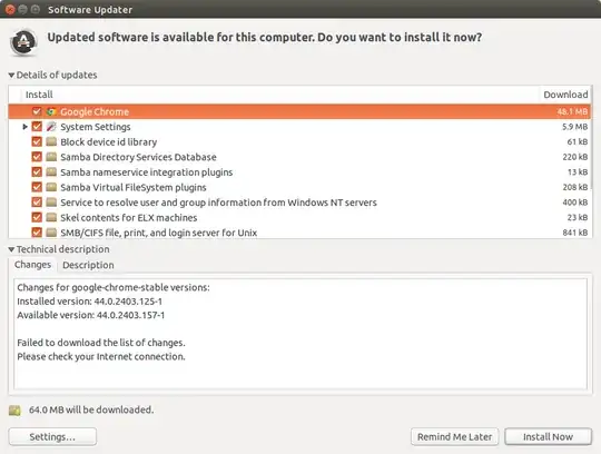

Here is a screenshot of my "Software Updater", how do I for example find the "community origin" (patch(es), discussions, etc, if any) of the Chrome update (Available version: 44.0.2403.157-1) which is highlighted in the screenshot? Then when this update is installed, where do I find info about it on my machine?
Software Updater

The terms "Stable Release Updates" and "Security Updates" (don't forget them!) apply to packages in main, universe, restricted and multiverse. PPAs or other third-party repositories may have their own release schedules and policies. In your screenshot I see "google-chrome-stable" -- this is not a Ubuntu package and it does not follow the Ubuntu release schedule.
