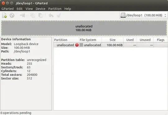

Run gparted passing the loopback device as an argument:
sudo -H gparted /dev/loop1
screenshot1
Click on "Device" -> "Create Partition Table...":
screenshot2

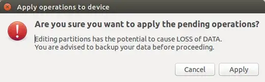

Click "Apply":
screenshot3

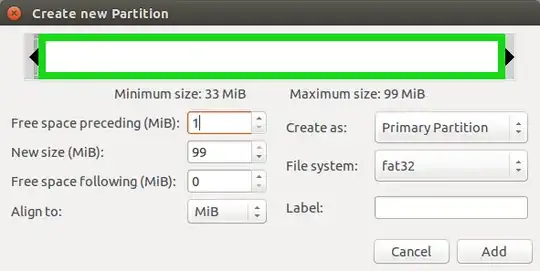

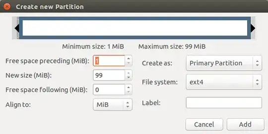

Click on "Partition" -> "New":
screenshot4
Select "fat32" from the drop-down menu:
screenshot5
Click "Add":
screenshot6

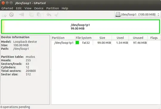

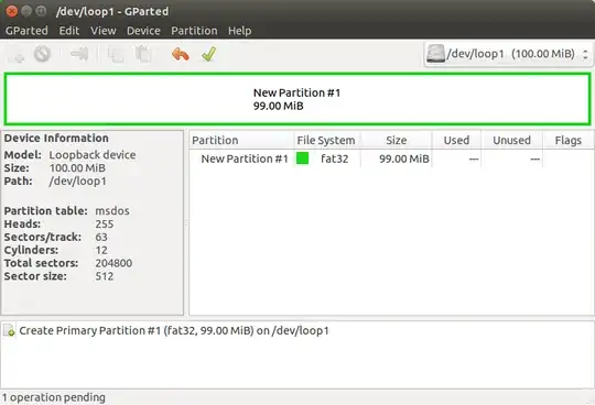

Click the green tick:
screenshot7

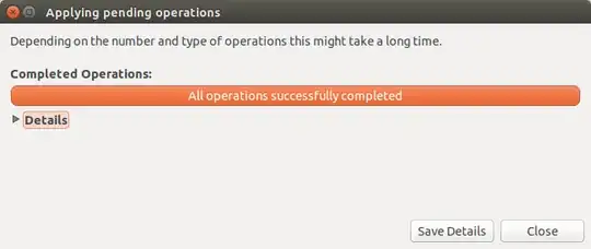

Click "Apply":
screenshot8
Click "Close":

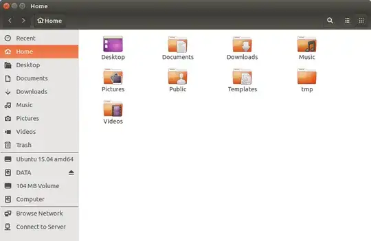

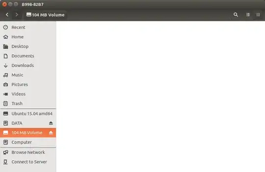

You can use the created image for whatever purpose you want; for example, you can use it as a virtual USB drive:
sudo losetup loop1 image.img
Opening Files:
screenshot10
screenshot11
