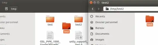

But then , nautilus gets into the game:
Moving symbolic link to the location where de directory is in nautilus
Nautilus understands that the symbolic link is a directory, and it kindly offers me to merge them:
Now, I merged them (I obviously thought it was two different directories). And as a result...
