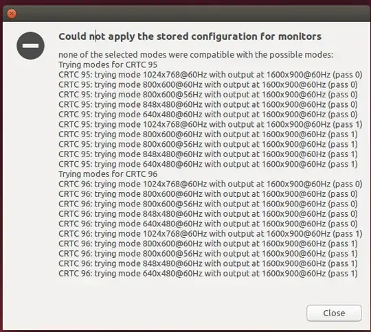

Here's the error message I get after reboot:
error
