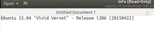

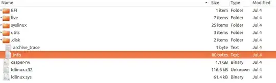

There will be a hidden folder called .disk. So, if you are in Nautilus hit Ctrl + H to show hidden files.
Inside .disk there is a file called info which if you open, will tell you the Ubuntu version, including the architecture (32-bit or 64-bit).
