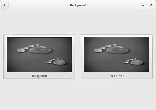

Gnome Settings
You can control the screensaver via Settings > Background, sorry but there are no more options in the GUI.

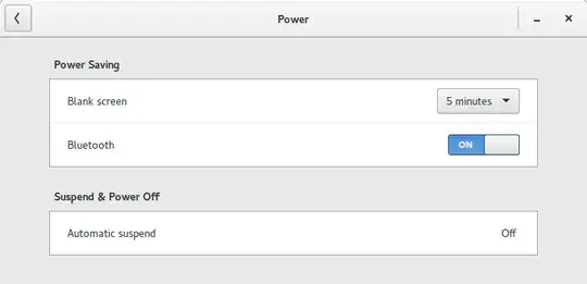

and via
Settings > Power

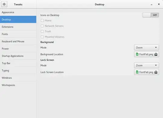

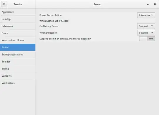

Tweak Tool
A little bit more options are in the Gnome Tweak Tool
