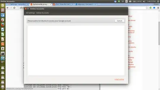

However Online accounts still don't work(same for rhythmbox and other GTK3 programs). A white screen appears like this:
Any suggestions on how it can be solved?

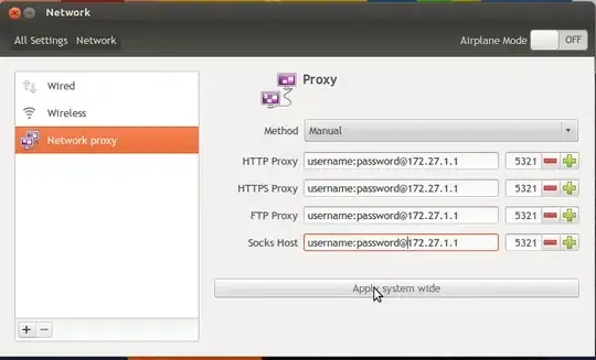

Solved it finally:
(Follow the steps serially)
1. For gtk3 programs such as rhythmbox and online accounts:
First you need to enter proxy settings in network settings (along with authentication):
Then apply system wide.
