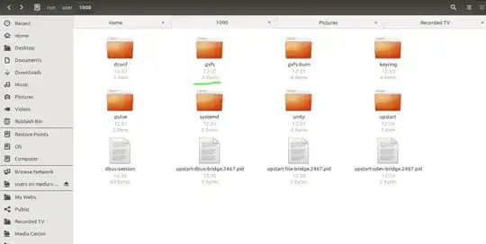

I can't seem to locate the GVFS folder in Ubuntu 15.04 has its location changed from 14.10?
The old location:
/run/user/1000/gvfs/
Is always empty, no matter how many samba shares are mounted. View of gvfs folders showing empty despite a samba share being mounted.
So has the location moved? The reason that I ask is that I am having problems playing video and music files from Samba shares since upgrading from 14.10 to 15.04 and I am guessing that gvfs is the cause.
I have tried another answer that suggested that I install gvfs-fuse, but this was already installed - a re-installation didn't help.
I guess a second question would be if the location is the same, why isn't anything mounting there anymore?

This is a confirmed bug in the gvfs package:
https://bugs.launchpad.net/ubuntu/+source/gvfs/+bug/1451087
a workaround at this moment is to first kill both gvfs deamons before trying to mount.
To do so just execute the command:
killall gvfsd
from a terminal.
Now you can find your mountpoint again in:
/run/user/XXXX/gvfs
