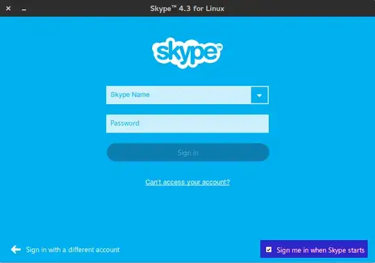

To make Skype auto-login when it starts launch Skype, then login with the automatic login tick box selected (I have highlighted the bit which you will need to tick in the bottom right hand corner):
After you have completed that part, you can then do as @Harris says to make Skype launch automatically when you login:
Move your skype.desktop file into your autostart folder with:
cp /usr/share/applications/skype.desktop ~/.config/autostart/
And you shouldn't need to make the skype.desktop file executable for it to work.

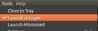

In SkyPe Beta, there is an option to launch at login
Tools > Launch at Login
