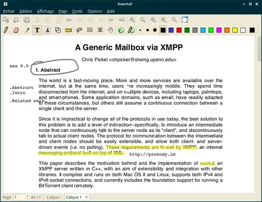

You can use Xournal - Ubuntu Apps
Xournal is a GTK+ application for notetaking, sketching and keeping a journal using a stylus. It can also be used to add annotations to PDF files.
Xournal
To install:
sudo add-apt-repository ppa:nilarimogard/webupd8
sudo apt-get update
sudo apt-get install xournal
Optional, to remove Xournal, run:
sudo apt-get remove xournal

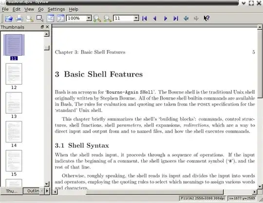

DjVuLibre which is an implementation of DjVu, including viewers, browser plugins, decoders, simple encoders, and utilities.
DjVuLibre

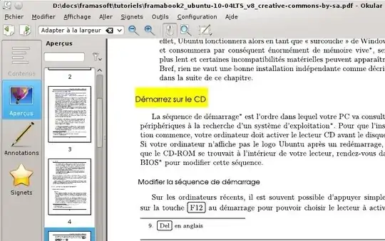

Okular is a universal document viewer with support for advanced document features, such as highlights,annotations, forms, and embedded files.
Okular
To View djvu files using Okular :
apt-get install okular-extra-backends
