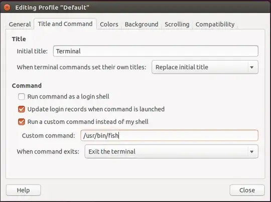

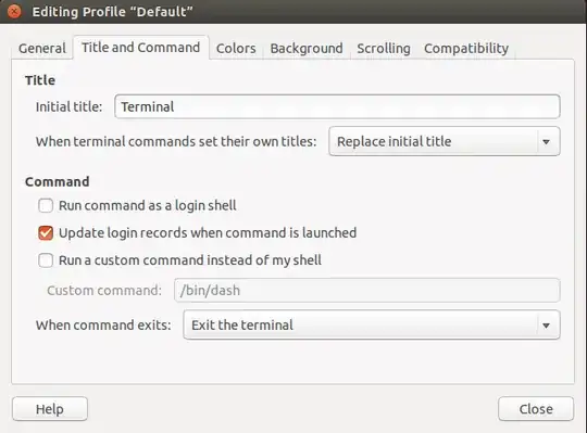

To set fish as the default shell for gnome-terminal, from gnome-terminal go to :
Edit > Profile Preferences
then go to Title and Command tab, you will get :
before
Change it as :
after
Now whenever you start a new instance of gnome-terminal, fish will be started instead of bash.
