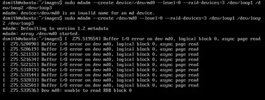

EDIT: Using mdadm I get this error:

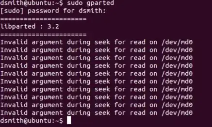

EDIT: Output of sudo gparted /dev/md0

I literally just did touch image#.img for each one. Is there something else I should do?
This is indeed the problem. The files are 0 bytes, and you cannot seek inside them. You have to make files that actually have a size. It can be a a sparse file if you want:
