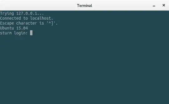

Using a simple desktop file:
  • Create a new file in ~/.local/share/applications
    nano ~/.local/share/applications/telnet.desktop
  • Add the lines below
    [Desktop Entry]
    Name=Telnet localhost
    Comment=Telnet client
    Exec=telnet localhost
    Icon=terminal
    Type=Application
    Terminal=true
    Categories=Utility;
    StartupNotify=true
    StartupWMClass=telnet
  • The line Exec= …, two possibilities
    1. Exec=telnet localhost
      I'm using localhost as target host. replace localhost with your target host.
    OR
    1. Exec=/full/path/to/your/telnet_script
      Use your own script if you want, eg
      #!/bin/bash
      telnet localhost
      Make the script executable and add the full path to your script to the Exec= property
