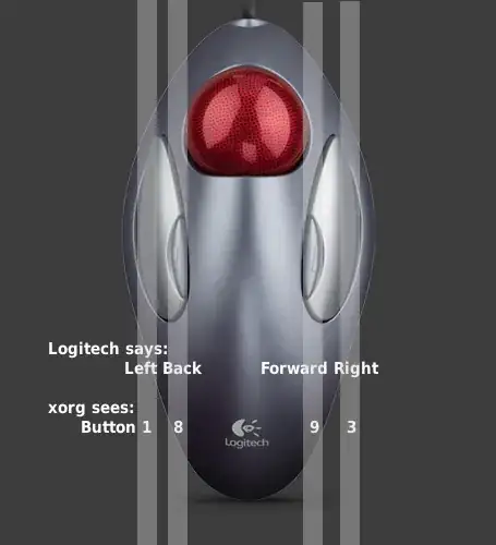

    This indicates that button 2 operates the scroll feature; however, the following diagram shows that there is no button 2:
    Logitech Trackball
    My preference is to hold the small right-hand button when scrolling.
  5. Configure the small button as follows, where 10 is the device and 9 is the button number:
    xinput set-prop 10 "libinput Button Scrolling Button" 9
