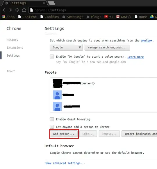

You can set up multiple users, each with their own profile. And then you can right-click on the current user's name near the top right-corner of your Chrome window to change users (not shown in the image below).
chrome://settings
