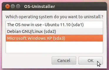

Before doing anything drastic, always make a back-up and then go on to the easiest and safe way to do this is using os-uninstaller.
  1. Boot to Ubuntu from a LiveCD/DVD/USB
  2. Open a terminal by pressing ctrl+alt+T and copy paste:
    sudo add-apt-repository ppa:yannubuntu/boot-repair
    sudo apt-get update; sudo apt-get install -y os-uninstaller && os-uninstaller
  3. Open os-uninstaller from the dash and you'll get this window:
    choose the OS you want to remove. You'll be asked to confirm, click OK and wait tell it finishes removing.
