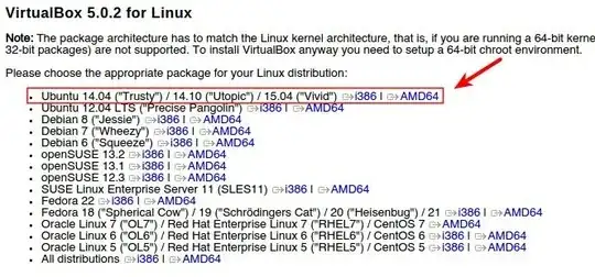

The easiest way by far would be getting a hold of the .deb of Virtualbox 5.0. Simply go to Virtualbox's website and then get the 5.0.2. build for Ubuntu 14.04. If you're running a 64bit system, then grab the AMD64 deb. If you're using x32, then you will need to grab the i386 build.
File to pick when you're on Virtualbox's website
After that, simply go the destination that you saved the .deb file and then double click. Ubuntu Software Center will open and you should be able to install it by that way.
