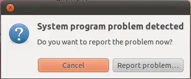

My Questions could be a similar to this. But i need...
System Problem Detected
Where does the problem will be reported?
What would happen if we cancel it?
What could be the possible Reasons of such occurrence?
Is there any Log/History files to view the sent Report?
How to know that the problem was solved or being solved?
Ways to report it manually, if we found? Do Help me !
Launchpad in general and specifically: to the package the crash occurred on. By the way: if this specific crash is already known you will get a notice regarding that.
No report will be filed.
Bug in a program. Faulty hardware. Unsupported features in hardware.
The program apport (Ubuntu specific) stores crashes in /var/crash. (See https://wiki.ubuntu.com/Apport and this on U&L).
Track down the bugreport number and visit Launchpad.
Sure you can manually report a bug on Launchpad BUT you will need to get all the information added to a bug report otherwise it will be marked as "incomplete".
