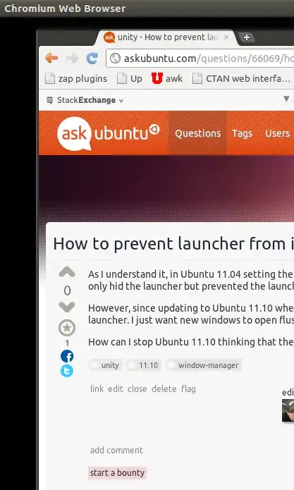

The following screen shot shows what I'm talking about. I've just opened chromium and the window is indented by the width of the launcher.
If you want all your windows to be initially placed in the top left corner, the follow settings in ccsm > Place Windows makes it work for me: in the fixed window placement tab, add an entry for Windows with fixed positions and set the type to any, x to -1, y to 48 and untick keep in workarea. It's quite a hack and the window is 1px off screen (which you'll hardly notice).
I usually use the ccsm Grid plugin to place my windows, since I normally want them side-by-side anyway i.e. Alt-Kp-4 for left tile, Alt-Kp-6 for right tile etc. Grid ignores the launcher if set to auto-hide.

Just move the window to the left, and the launcher will go away. It is only auto-hidden when something else wants that space.
I wonder if this worth a shot:
Go to CCSM - (Window Management)Place Windows - Enable "Workaround" & Placement Mode "smart"
