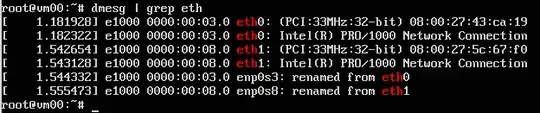

To find out interface names assigned by Ubuntu for your environment, you can dmesg | grep eth.
