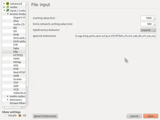

Have you tested changing the Caching Value under preferences ( ctrl + p, then Show settings: all ) enter image description here If you are using NAS as your media storage you should change in the SMB Access Module.
Test setting it to 0 if you are reading the file from your HDD.
