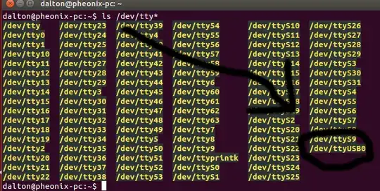

To find it, connect your device and execute:
ls /dev/tty*
It should be listed as shown in the image:
