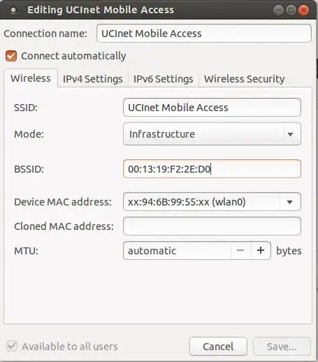

There are no less than eleven SSIDs in range with the same name. In your message log, we see your wireless device roaming from among them.
I suggest you ask your wireless to bind to your access point. Right-click the Network Manager icon, select Edit Connections. Fill in the MAC address for your access point; find it with:
sudo iwlist wlan0 scan
For example:
Cell 05 - Address: 00:13:19:F2:2E:D0
                Channel:6
                Frequency:2.437 GHz (Channel 6)
                Quality=66/70  Signal level=-88 dBm
                Encryption key:on
                ESSID:"UCInet Mobile Access"
Use the address (MAC address) you found for the strongest access point to place in BSSID in Network Manager:
Save and close.
