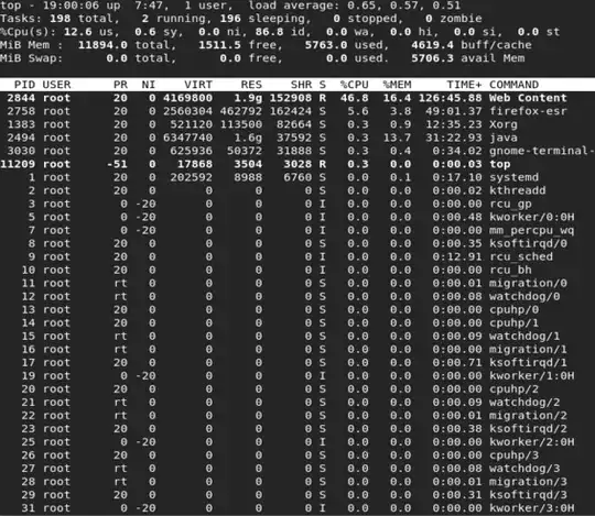

To see the current "niceness" and PR value of a process the following command can be executed:
top
Which shows the following output:
top screenshot
In the figure the PR and NI values are displayed. It is good to note the process with PR value -51 that corresponds to a real time value. There are also some processes whose PR value is stated as "rt". This value actually corresponds to a PR value of -100.
