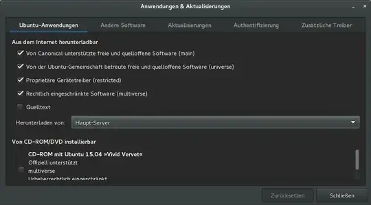

I recognized this problem from time to time and from amchine to machine. I got rid of it by simply changing the to main mirror server - called in the german version you are using "Haupt-Server" enter image description here
Since I changed away from "German Servers" to "Main Server" everything is fine...
