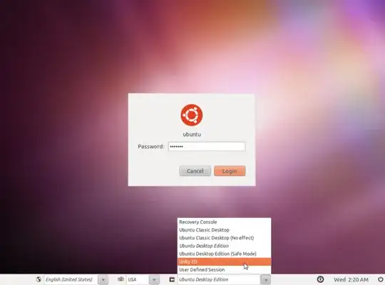

If you are using 11.04 with a card that does not support 3D very well you will be greeted with the default Ubuntu desktop, not Unity.
There is a solution for you - use Unity2D!
Then log out and when logging back in select "Unity 2D" at the bottom of the login screen.
