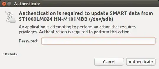

PS: I've been getting this prompt very often on resuming the notebook from sleep.
There have been other users reporting about the annoyance of this dialog on the internet, with no clear explanation what this dialog is all about. This started appearing only when I upgraded to 15.04. Can this be related to my fsck problem?
