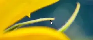

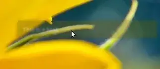

Almost what you asked for, and possibly what you might like, a tiny, very light background script (no noticeable load to your system whatsoever, if no notification runs, it will only wait/check for one to appear) that will change the mouse-over effect of the notifications from fade:
to disappear (close):
This will only take effect if the mouse is moved from outside the area into the notification area, to make sure you won't miss the notifications if your mouse already is in the notification area if the message is launched.

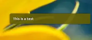

    with the script running, open a terminal window and run the command:
    notify send 'This is a test'
    now move the mouse to the notification. Instead of fading, it should disappear.
