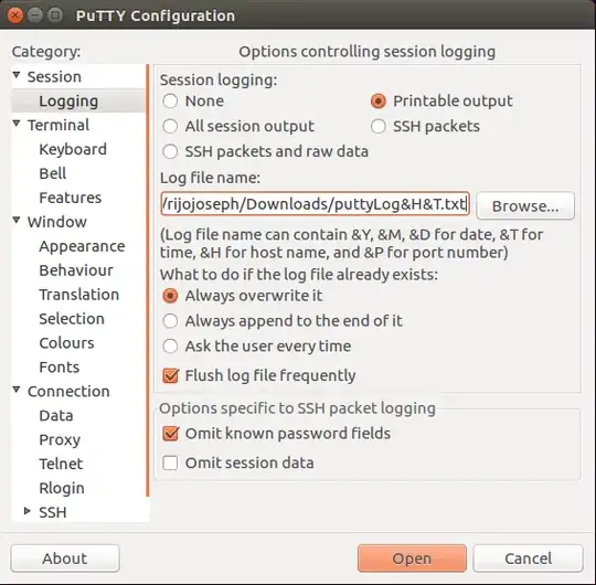

There is an ugly way that I use to copy from Putty console. In Putty configuration window, I have enabled Session Logging to get the console output dumped to a file on my system.
My Putty Session Logging Configuration
Then I tail the log file in a local terminal with command:
tail -f <logFileName>
When I have to copy something, I go to the local terminal where the log is being tailed and copy what I need with CtrlShiftC.
