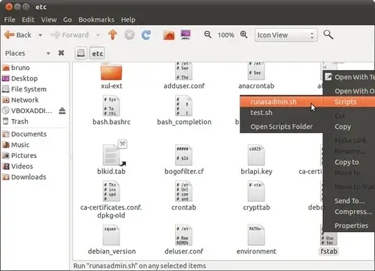

Now you can run your script using sh <nameofyourscript>.sh on a terminal, by double clicking on it and selecting run on the dialog box or put them in your ~/.gnome2/nautilus-scripts/ which then will be available on your scripts menu when you right click on nautilus:
Create a right-click "Open as admin" without password
To create a scrip that opens files using administrator permissions by right clicking on them and making it so that no passwords will be asked create a script with the following:
#! /bin/bash
for file in $NAUTILUS_SCRIPT_SELECTED_FILE_PATHS; do
gksudo "gnome-open $file" &
done
Save it on your ~/.gnome2/nautilus-scripts/, make it executable with sudo chmod 755 ~/.gnome2/nautilus-scripts/<nameofyourscript>.sh, using sudo visudo add the line <yourusername> ALL=NOPASSWD: /usr/bin/gnome-open and save the file.
You should be able to right-click a file, move to your scripts folder and selecting the script you just created to open that file using root permistions. gnome-open will handle the file type as good as possible.
click on your openasadmin script
done!

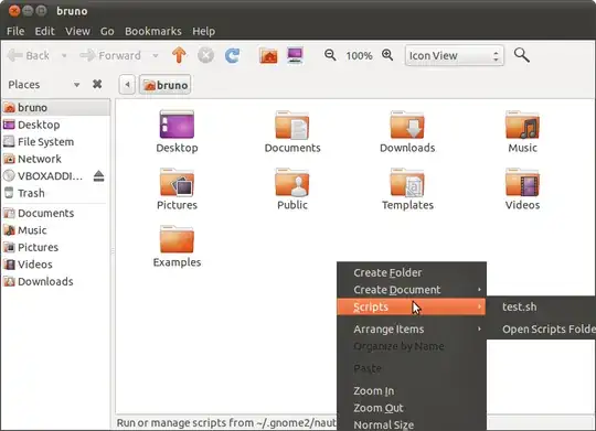

Nautilus scripts usually are to be placed in $HOME/.gnome2/nautilus-scripts/ and need to be executable. That being said, the follow script should do, what you want:
#!/bin/bash
IFS='
    gksudo -k "sh -c 'chmod +x $file; $file'"
done
You can access that script from nautilus by right clicking on the file, hovering over the script menu and then clicking on the filename of the script in $HOME/.gonme2/nautilus-scritps/. You still have to enter your password though.

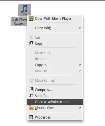

You can use this Nautilus extension. Nautilus-gksu Install nautilus-gksu.
sudo apt-get install nautilus-gksu
Installing it adds a 'Open as administrator' entry in your nautilus right-click menu.
When you need to open any files with root permission, you just have to right-click on the file, select 'Open as Administrator', as simple as that.
