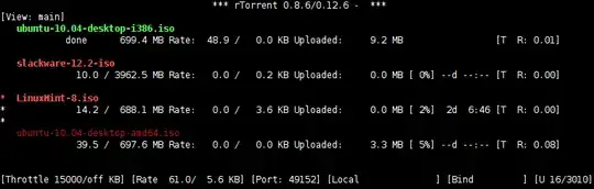

rTorrentsoftware-center image
rTorrent screenshot
I have written a detailed tutorial about rTorrent, including its installation and configuration. Check it out here or see the official user guide.
rTorrent's pros
  • lightweight
  • ultra-fast downloading speed
  • very effective BitTorrent traffic encryption
  • supported by all the private trackers
  • very customizable

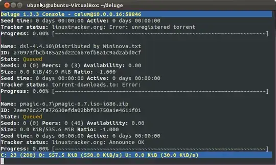

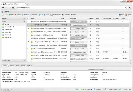

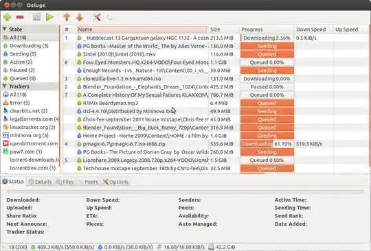

Deluge deluge install
Deluge is a fully featured, yet lightweight torrent client that is written in Python and utilises libtorrent(rasterbar) C++ library at its core.
  • Standalone or Thinclient mode (split core/ui) to enable connecting to daemon (deluged) running remotely or in the background.
  • Multiple user-interfaces, supports access from most platforms:
    • GTK UI
    • Web UI
    • Console UI
  • Many Plugins and application extensions
  • Supports all the usual bittorrent client functions: DHT, LPD, PEX, UPNP, Encryption, Proxy, etc.
