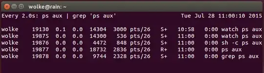

I have managed to reduce the issue down to a single line. When running
watch "ps aux | grep 'ps aux'"
in a terminal, you usually get several lines of output, as is expected.
output showing 5 results

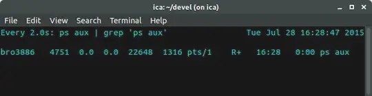

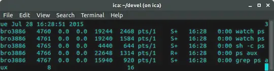

Note that the top three lines are cut off, and just barely fit ps aux at the end. When you reduce the size of your terminal to where it does not fit any more, it is cut from the results completely.
output showing 2 results
This means that grep only receives the cut off output. What I find most baffling about this is the extremely limited scope for which this happens. It does not happen for either of
