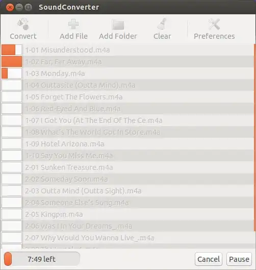

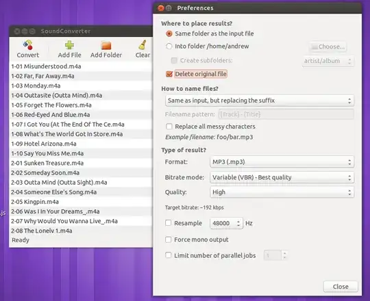

SoundConverter can do this without having to mess around on the command-line, and it's available in the Ubuntu Software Center:
Install via the software center
soundcoverter main window and prefs
conversion inprogress
