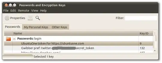

Ubuntu One is storing your credential inside Gnome Keyring Manager. You can access this manager from the System -> Preferences menu (or in older Ubuntu release from the Applications -> Accessories) choose the application named Passwords and Encryption Keys.
You can see that your Ubuntu One credentials are stored there.
Note that this keyring manager is encrypted, it's a safe store. But it is unlock upon login, so that's why you don't need to enter your Ubuntu One credentials.
