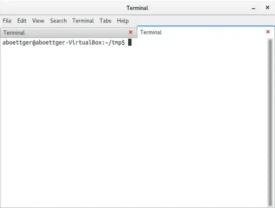

Using a custom command for your mate-terminal profile, eg:
sh -c "cd your_folder; exec bash"
Replace your_folder with your preferred folder and bash with your shell if you need another one than bash
The terminal in action
