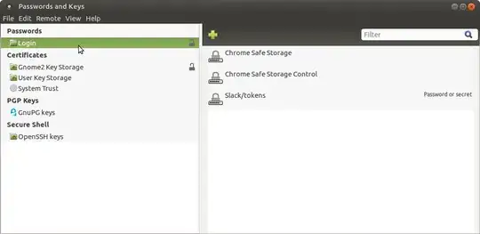

  1. Start up Ubuntu's Dash (top most icon in Unity or press Super)
  2. Type Pass to get Passwords and Keys and start this (this will start the Gnome Keyring frontend seahorse)
  3. Next
    • If the password is known: Under Passwords the default folder select unlock, or
    • If the password is not known: right mouse click and delete for resetting.
Next time Ubuntu will ask for a new password for the keyring.

Solved this by installing seahorse frontend.

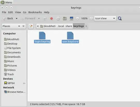

The answer for removing the specific file for rm ~/.local/share/keyrings/login.keyring does not work on all forms of Ubuntu.
One should open up the file manager and show hidden files (CTRL + H). Then one should see .local/share/keyrings delete all of the files in this directory and you should be good to go.

I'm on Ubuntu MATE 16.04 and deleting files in ~/.local/share/keyrings/ didn't help me. What helped though is running seahorse and changing login password. I entered my current password and typed the same as new one. Then I logged out and logged is and my login password became password for Gnome2 Key Storage.

The following will not work to solve this problem: rm ~/.local/share/keyrings/login.keyring because there are two key rings, login and user So: rm ~/.local/share/keyrings/*.keyring will remove both.
It's really difficult for the problem to remain after deleting the key rings, since they no longer exist, and new ones must be created! This is the case when the password is unavailable.
With that option, you'll need to reenter your various passwords that were stored previously on the key ring, as you use the applications that require them. The key ring will remember each one, and that will be it.
