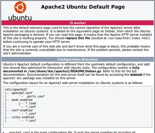

Finally, test Apache and PHPMyAdmin to see if everything went right;
Test Apache by opening http://localhost in your web browser; if everything went right you should see this:
apache

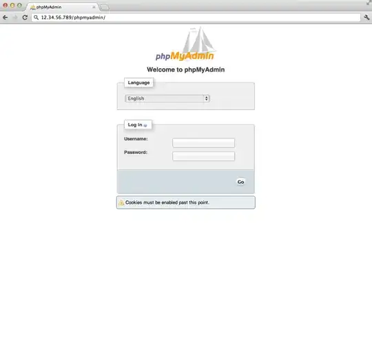

Test PHPMyAdmin by opening http://localhost/phpmyadmin in your web browser; if everything went right you should see this:
phpmyadmin
