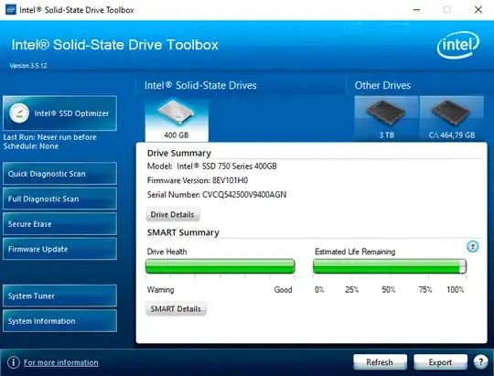

The accepted answer explains the theory; I'd figure I might add a little real-life data from two of my systems.
Desktop system
  • Has a 400GB Intel 750 SSD.
  • Has 32iGB of RAM; swap isn't needed often.
  • However, it hibernates regularly (say, once a day), requiring a large swap write.
  • Has been in use for just over 4 years.
  • Runs Debian on ext4, and a swap partition.
  • Used to contain a Windows 10 installation for a couple of years, but no longer.
  • Has no configuration to spare the SSD (no swappiness tweaking, etc).
According to SMART, it has seen 28TiB lifetime writes (19GiB/day). The ext4 filesystem has seen 18TiB lifetime writes (12GiB/day). The remainder is due to swap and the Windows installation.
According to Intels SSD Toolbox, the drive is in excellent health and has about 95% of its lifetime remaining:
Intel SSD Toolbox summary
